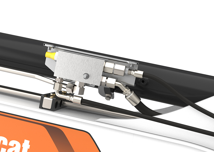

Excavator Demolition Kit Rendering
Nice image!
If I may give some tips, I would suggest adding some textures to more of the materials, some of them look a bit too perfect which makes them look unrealistic. Just a subtle noise texture to the bump can make a big difference and is easy to do. Or a texture to drive the roughness, for example.
Also, the edges look unnaturally sharp, but there’s a feature in Keyshot where you can add a radius to the entire model that you can make use of. If you apply something like a 0,5mm radius it would look more realistic, and often gives nice reflections on the edges!
Good luck!
Thank you for the advice!
I did add a radius, but it was only .1 mm. I will try to increase that next time. I was trying to adjust the roughness with little success, but that totally makes sense to add the noise texture.
